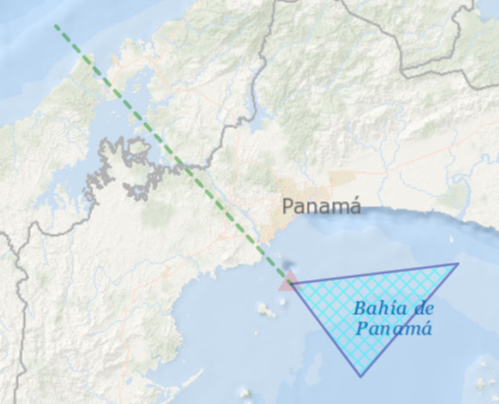

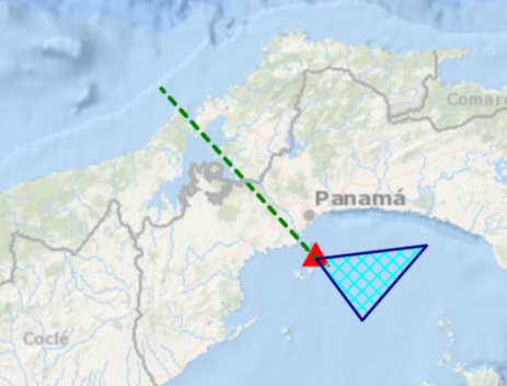

If I go into the "Create a new Feature Collection Layer" sample, and add a double click event handler that decreases the opacity of just the first sublayer, the opacity of all sublayers decreases on the map (even though the other's Opacity value is unchanged).
Before:
After several doubleclicks:
Thanks, Kirk
