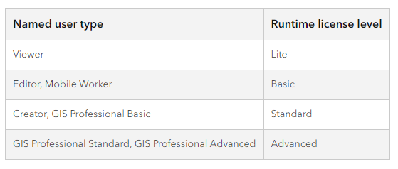

Here it said: To obtain a Runtime production license using one of these named user types, use:
  • ArcGIS Maps SDK for .NET 200.0 or newer
  • ArcGIS Runtime SDK for .NET 100.7 or newer
    If it's role based license model as it looks like so, suppose I am a Viewer:
    1)  Where should I go to get the SDK that ties to the "lite" licence? Doesn't the SDK reside in some other places rather than on Nuget? The one SDK showed up in Nuget has the watermarks, I supposed I wouln't go there again for the lite version SDK, right? The instruction is unclear as to where one can get the non water-marked SDK !!
    Similarly, if I'm an Editor, where should I go to get the SDK "basic" licencse?
    Also 2) how to determine the version 200.0 or newer, or 100.7 or newer?
    The adminitrator can probably give me a role I want, but does she know where to get the SDK that corresponds to each role? Am I to figure this out myself?

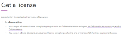

I must login in order to see the license, it looks pretty much like a token - with hex strings. I wish someone could have told me this beforehand becuase as I finished read the reference links given, nothing showed up on this particular page as a anonymous reader, I just got  a general ideas and still wonder where/what, until one fine day I decided to login at the developer site and there it was at the very top of the page.
MichaelBranscomb
Esri Frequent Contributor
Hi,
Thanks for confirming you were able to get your Lite license string. Sorry if you had trouble finding the right information - the information you needed was at the top of the Get a License topic:
We're always looking for ways we can improve the doc, particularly regarding licensing and deployment. If you have any suggestions, we'll be happy to take them.
Thanks
