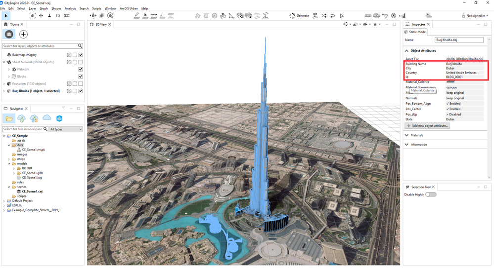

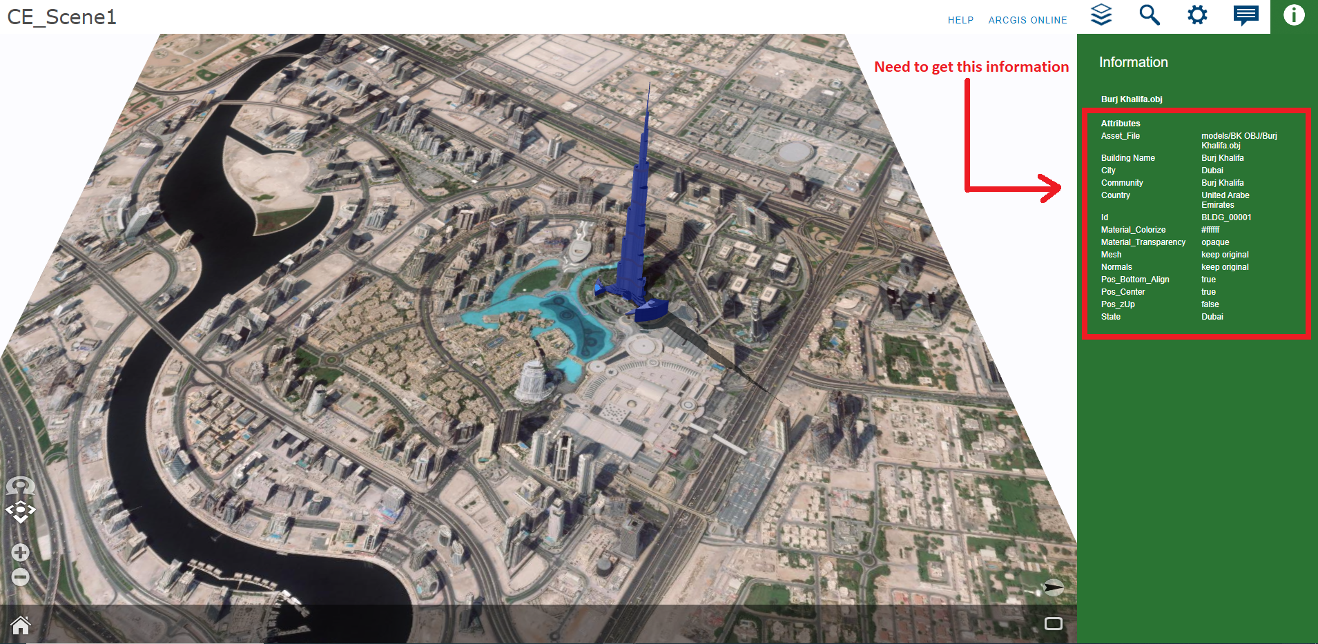

I created the sample WPF application using ArcGIS Runtime SDK for Dot Net.
I load the local slpk file with one building.
I cannot able to get that building attributes at runtime.
How to get that building information, when I click that building?
like following figure.
 Please give us advice
Thanks

But, I needs to get the object attributes , Which is given by the city engine object attributes in WPF application using ArcGIS Runtime SDK.
see following figure
City Engine SceneCity Engine Scene
Thank You
