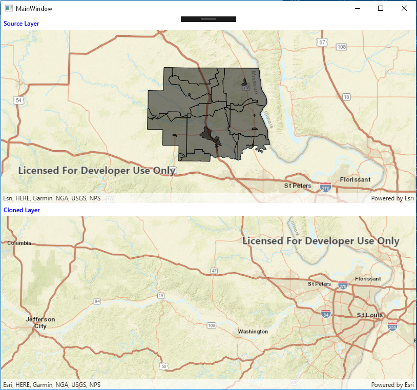

Thus null values are returned for many of the FeatureLayer properties, such as the Renderer or FullExtent. This also means that the Layer itself is not visible on the map.
Source layer on the top map, cloned layer on the bottom map.

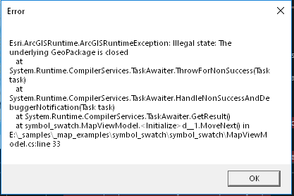

To load the layer we would call LoadAsync(), but doing so on the cloned layer, creates the following error:
Error returned on LoadAsync() of cloned layer
Is this a bug, or is there something I am missing about cloning Geopackage FeatureLayers?
