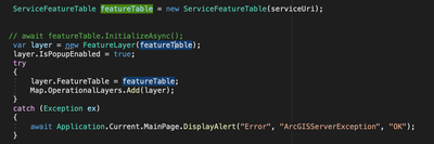

Feauture layer has been added it's showing up on the map.

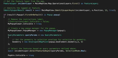

batkaj
The popup is working mumps which is downloaded.
not working on feature layer. 

Is `result?.Popups?.FirstOrDefault() is Popup` true? Does that feature layer have popups configured?

result?.Popups?.FirstOrDefault() is Popup giving null.

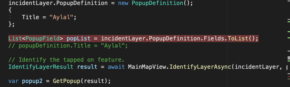

Did you define a popup definition on your feature layer? Otherwise that collection would be null.
batkaj
didn't
I'm looking at this code https://developers.arcgis.com/net/wpf/sample-code/show-popup/
do you have a example popup definition.
batkaj
Popupdefinition still the same.
