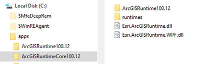

To clarify, I set up what I thought was a simple test, but if I made a glaring error another set of eyes always helps.  I created a deployment which looks like this:
And here's the code for App.xaml.cs:
