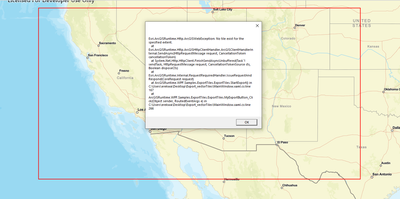

So I'm occasionally getting an error with my ExportVectorTiles. Depending one where I try to export from I will get an error like this...

LukeSmallwood
Hi @johnmarker thanks for sharing your code. From the error message it looks as though you are trying to export tiles from an area with no data (e.g. away from land) - is that correct?
