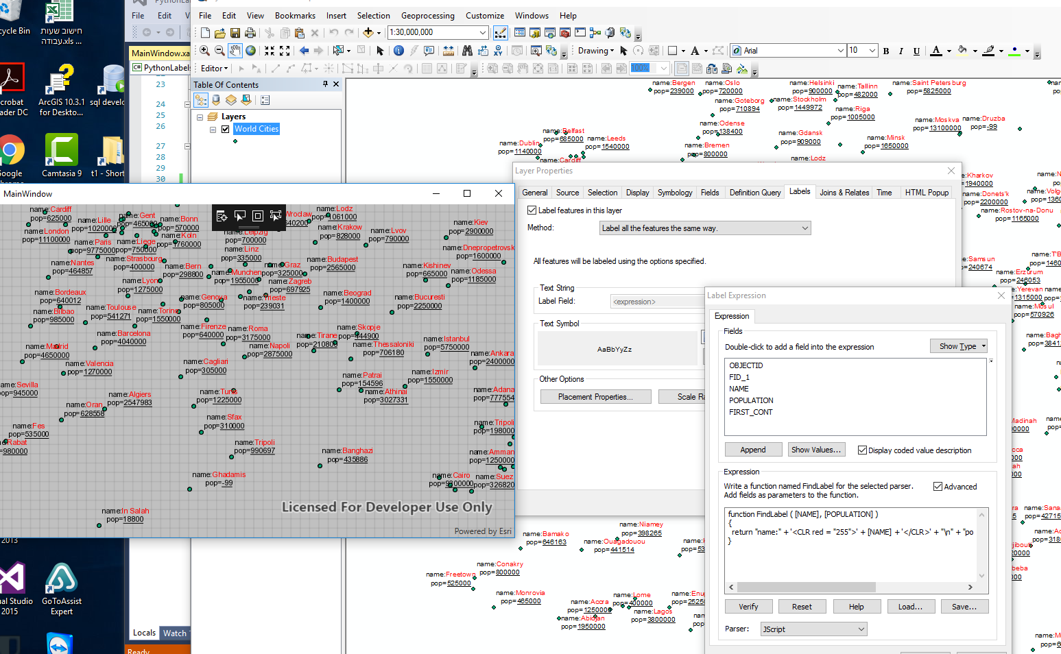

I just tried to create labels in JScript and it looks like it is working!!
In the screenshot you can see the expression and labels in ArcMap and the RunTime application (version 100.0).
screenshot
