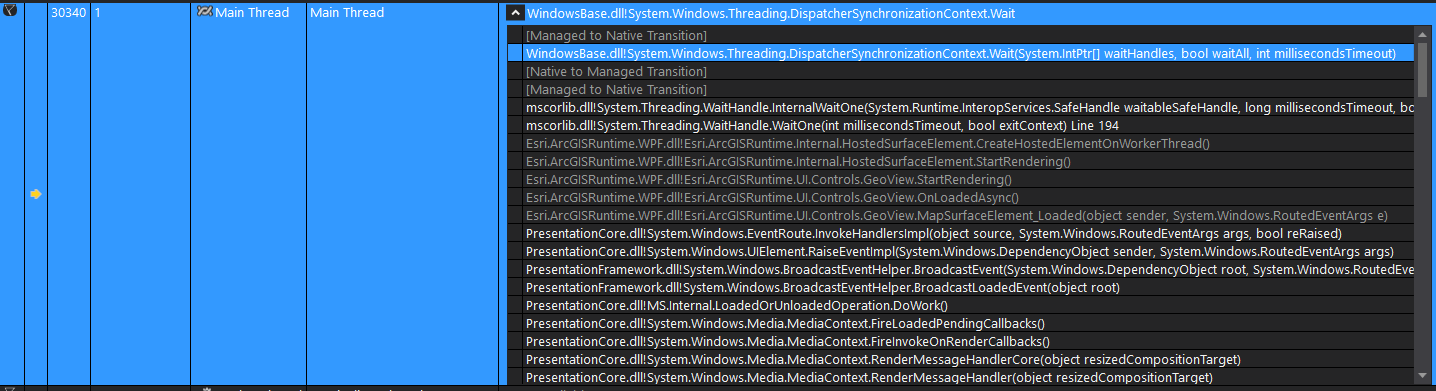

Hi,
i'm using DevExpress 19.1 and arcgis runtime 100.9,
using the dev express docking capability to detach part of the ui to a stand alone view,
the entire app freezes when there is a loaded map inside the view i'm detaching
the main tread freezes with the following call stack :
none of my code exists in the call stack.
any idea?
Adding the entire call stack of main thread -

6 Replies
dotMorten_esri
Esri Notable Contributor
When you hit the breakpoint, could you go to Debug -> Save Dump As... and share the dump that's being generated?
Also if you have a small app that reproduces the problem, I'd love for you to share it.
dotMorten_esri
I do believe I have a workaround for you: Try adding this in your application startup:
AppContext.SetSwitch("Switch.Esri.ArcGISRuntime.DisableSecondaryUIThread", true);
(But if you can share a reproducer, I'd still like to have it so we can get to the bottom of it)
YaronAvraham
Thanks, looks like the DisableSecondaryUIThread flag did the job, can i play with this flag while the program is running? i want to attach to OnBeforeDocking action  and set it to true, and after docking action is finished set it to false again, is there a way i can test that secondery ui thread is really on?
(I'll try to reproduce this issue in a side app)
Thanks!
YaronAvraham
looks like i cannot use this flag on before docking event.
for now i'll have to either turn it on startup
or use a workaround - remove the UI element that contains the map view from the xaml on before docking event, and put it back into the UI after the action of docking is finished, i really hope you could solve this issue in future releases.

Yes you have to set this setting prior to creating the MapView control - it cannot be set on-the-fly.
We would love to solve it, and a small reproducer would go a long way for us to address it.
MichaelBranscomb
Esri Frequent Contributor
Hi,
We suspect there's a good chance that this issue was resolved in the recent v100.12 release (when fixing BUG-000140934 The MapView window created by a custom control is not responding (https://developers.arcgis.com/net/reference/release-notes/100.12/#issues-resolved)
Thanks
