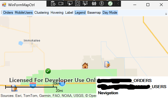

Hi, I'm new to ArcGIS and I'm trying to make use of the legend control from Esri.ArcGISRuntime.Toolkit.WPF, 200.8.0.  The map shows the symbols as expected, but the legend only shows the names of the layer and not the symbols.  I have 21 symbols defined in the ORDERS style, and 31 symbols defined for the USERS style.

If I'm not mistaken, Legend isn't supported for a DictionaryRenderer. Try calling _myFeatureLayer.GetLegendInfosAsync() and see if it returns anything.
MichaelChau1
I guess the answer is no?  What options do I have?  Thanks!
