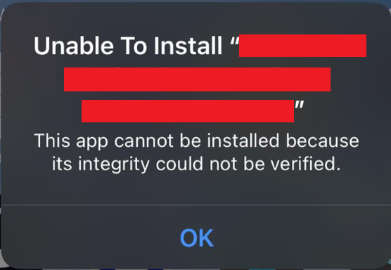

In particular, we're seeing the following OS error: Unable To Install <app name>. This app cannot be installed because its integrity could not be verified.

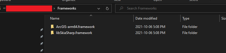

One interesting difference we've found is the included Frameworks in the built ipa.
In our working 100.11 app, we have two frameworks:

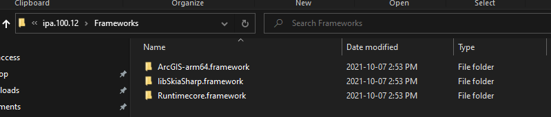

While in our 100.12 app, a new Runtimecore.framework has been added:

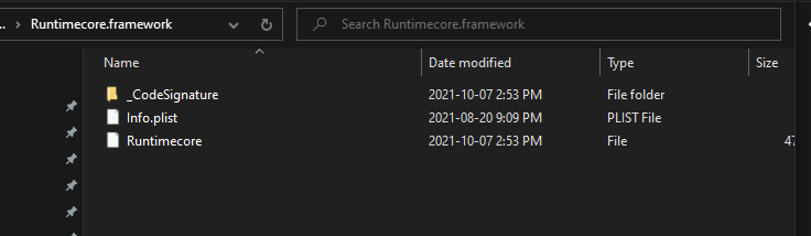

Drilling into the Runtimecore.framework, we can see a _CodeSignature folder.

We understand that Frameworks need to be signed. Perhaps the introduction of this new Framework could be related to the integrity issue? Perhaps its signing is not correct or consistent?
If you have any insight that might make heads or tails of this issue, it would be very much appreciated. Thanks again!
