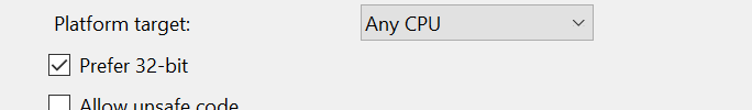

I've run into a head-scratcher.  I have two different apps using a common Runtime deployment folder on a 64-bit machine.  The first app is perfectly happy with just the client64 folder present, but the second app wanted the client32 present.  I was able to clear the problem by explicitly building the second app for 64-bit, but I didn't have to do that for the first app.  Any idea what would be causing this behavior?

My take is that you have Prefer 32-bit set in the second application properties which makes it trying to run the app in 32 bit mode. I would assume that if you build the app using Any CPU and Prefer 32-bit on, runtime tries to use 32 bit version. If you build the application directly to 64 bit, that doesn't have same issue.

Where the heck did that come from?  Did that appear in VS 2013 with update 5?  None of my earlier [VS 2013] projects have that set.  Thanks anyway for the tip!
Update: I did some searching, and the option actually appeared with VS 2012.  It's still a mystery as to why I haven't run into the problem with earlier projects, unless my memory is just messing with me. 😉
