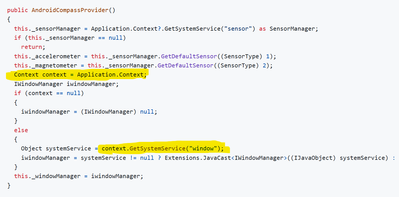

This error may trigger due to the lifecycle of the app, in case of pause/resume. Claude suggest that the IWindowManagerInvoker may be cached in a .NET class field, and become garbage collected on the Java side while on the .NET side an active reference is kept, to what is then a disposed object. That could explain the JNI details in the exception. Other reasons could be improper usage of JavaCast.
Claude also identified the Android WindowManager getDefaultDisplay to be a deprecated API at Android API level 30 / Android 11 (September 2020). Please see WindowManager  |  API reference  |  Android Developers
esp1rl
Summary
SystemLocationDataSource on Android can malfunction because its internal AndroidCompassProvider obtains an IWindowManager from the Android application context instead of an activity context. The application context is not guaranteed to be associated with a window, so the display properties retrieved from it may not reflect the actual display/rotation of the visible activity, leading to incorrect compass alignment and/or crashes due to disposed object.
Internal anatomy (relevant private structure)
└── AndroidCompassProvider (private field)
└── IWindowManager (private field)
The IWindowManager instance is used to query device display properties, which are then used to align the compass direction.
Root cause
The IWindowManager is created from the Android application context. Because the application context is not guaranteed to be tied to a window, the display information it returns can be wrong. The instance should instead be created from an activity context, which is associated with an actual window and display.
Workaround
  1. Create a new IWindowManager instance from the correct activity context.
  2. Use reflection to replace the private IWindowManager field inside the private AndroidCompassProvider field of SystemLocationDataSource.
Timing is critical: the replacement must be performed after SystemLocationDataSource.StartAsync() completes, because StartAsync() instantiates a new AndroidCompassProvider. The provider is set to null on StopAsync(), so the workaround must be re-applied after every restart.
Suggested fix
Note that IWindowManager.getDisplay() is deprecated precisely because of this class of problem. The recommended approach is to migrate to the newer display APIs rather than continuing to rely on the deprecated call.

Hi @GKmieliauskas The above workaround solves the problem for our MAUI application. Verified by Sentry monitoring.

I've not been able to reproduce the issue, but your stack traces were very helpful and we think we've resolved it. Once 300.1 ships, try that release. Thank you again for reporting this.
esp1rl
The release notes for 300.1 didn't mention this bug, but I've opened both 300.0 and 300.1 in DotPeek and verified there are code changes to Esri.ArcGISRuntime.Location.AndroidCompassProvider (internal class).
