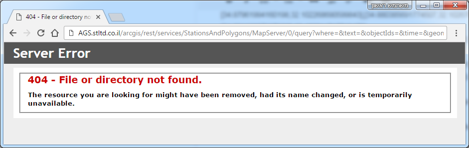

I've recreated this error using the "query" page of the feature service using the geometry's json and the GET method:
By using the POST method the query works fine.
