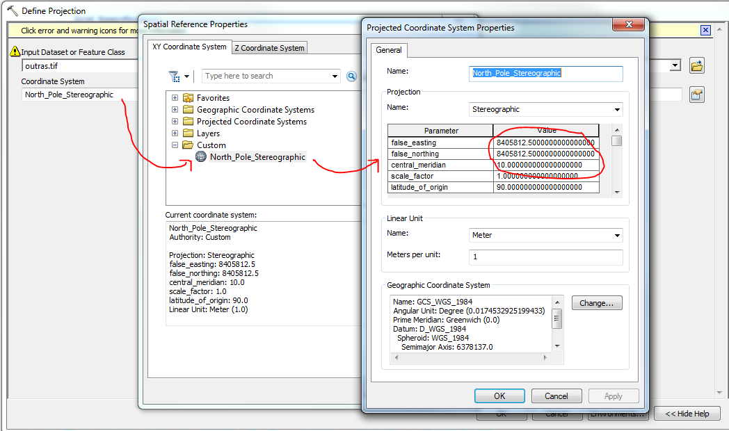

DarrenWiens2
MVP Alum
Here's a start that gets me close. I'm not 100% sure that it's even possible to fit this dataset exactly, in all parts of the raster at the same time.
The pertinent information can be found here​ (I'll note that they indicate that you can use the lat/long file [txt and xlsx attached], but you'd have to do a fair bit of manipulation to tie the points to the ASCII grid values):
Grid Specification:
North Polar Stereographic
ni (# rows) = 706, nj (# cols) = 706, bottom left grid point = (1,1)
Grid rotation -10°
Pole position = (353, 353)
Grid resolution at 60°N = 23812.5 m
So, your header should look like:
NCOLS 706
NROWS 706
XLLCENTER 1
YLLCENTER 1
CELLSIZE 23812.5
NODATA_VALUE 0 [or another value like 999 if you want to include values of 0]
You also need to define a custom coordinate reference system to make it line up with the world, once you've converted ASCII To Raster:
false_easting and false_northing = 8405812.5 = cellsize * pole position
central_meridian = 10
The final result is:
MarianneMortensen
Deactivated User
Thanks all of you for the answers. Darren, I appreciated your clear explanation - it worked just fine.
