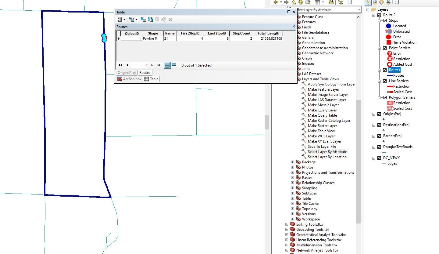

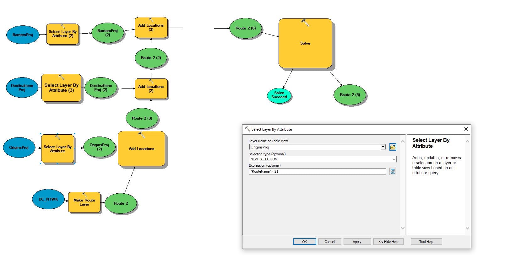

I have a model set up that successfully routes for one [RouteName] set using the "Select Layer By Attribute" tool in Model Builder. I have attached photos of my current model and my test result for using the expression "[RouteName]=21" in the select Layer by attribute tool for my Origins, Destinations and Barriers.
What I would like to do is be able to set the model to run through each "set" of [RouteName] (Origin, Destination, & Barrier all sharing the same value) and output/append that successful routing to a new feature class with the set's [RouteName} as an attribute. in the end of the model I would have 415 different routes, one for each trio of points.

You need to explore model iterators, you can then loop over your routes to select 1 start/stop/barrier, on each loop you create your selections that feed into the add locations tool then solve and append results
