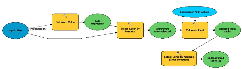

In ArcMap, the precondition route (no "If" tool as we have in Pro ModelBuilder) would be more complicated, so it may make more sense to build your select expression in Python using the Calculate Value tool with logic based on what fields are there, and pass that SQL expression to the select by attributes tool.
curtvprice
MVP Alum
Here's a solution that may work for you:
ModelBuilder fmodelModelBuilder fmodel
and my Calculate Value code to build your SQL expression to select the rows you want to calculate:

jhomme981
Greetings curtvprice:
Thanks!! I was able to dissect the logic and instruction you provided and now have a much better understanding! The calculation works and is waaay simpler than the road I was going down. Thank you again!
