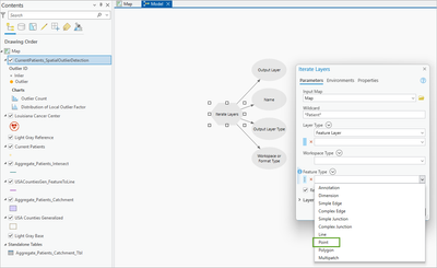

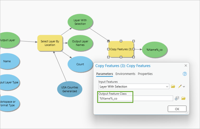

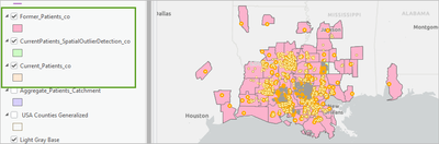

For example. I have a map with several point layers that include the string "Patients".  I can iterate layers, with the input Wildcard of *Patient*, the layer type of "Feature Layer" and the feature type of "Point". This will go through the three layers on my map that match these criteria.
I then use select layer by location to find the polygons in my counties layer that intersect those points. I use Copy Features with an inline variable on %Name% and a suffix of _co (short for counties), to export them to new feature classes. *Note* that you will need to make sure the layers on your map have names that are permissible geodatabase feature class names - "Current Patients" doesn't work because feature class names can't have spaces, but renaming the layer "Current_Patients" solves that... you could also use the Calculate Value model tool and ValidateTableNames (https://pro.arcgis.com/en/pro-app/3.3/arcpy/functions/validatetablename.htm) to catch and sanitize any offending characters, with a tiny bit of Python. Just renaming layers is simpler.
The model:
The result:
I added the result layers to my map:
Looks like this approach should work for you.

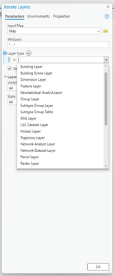

Unfortunately I'm not sure this advances my cause as Points are not an option within the iterate layers, Is there another route I can try?
BobBooth1
Choose "Feature Layer" - then you can choose geometry.
The model:
The result:

You can use Copy Features.
https://pro.arcgis.com/en/pro-app/3.3/tool-reference/data-management/copy-features.htm
That's where you'd be specifying the output name built with inline variable substitution.

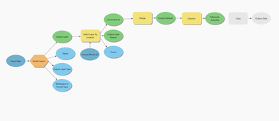

@BobBooth1 Thank you. Hopefully one last question. It looks like Select Layer by Location is passing the name of the polygon layer or the "Input Features" as the layer name, but I need it top pass the Point Layer or "Selecting Feature" on to the next step. How can I tell model builder to pass the Selecting feature name to the next step?
Probably worth mentioning that because Model Builder is passing the Input Features name rather than the selecting features name it is currently overwriting all previous iterations as the Input feature is the same for all iterations. If there is some other way I should be going about this, I'm all ears.
BobBooth1
Your Iterate Layers iterator has an output parameter called Name.  If you bracket it with % symbols, %Name% you can use that as a variable in output feature class names. This is called Inline Variable Substitution in ModelBuilder.
