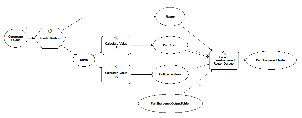

I'm using ModelBuilder to iterating over a collection of multispectral rasters to be fed into the pansharpen tool. I'm using inline variable sub for the pan image input (actually as input into Make Raster Layer first):
D:\SomePath\%PanImageName%.tif
where %PanImageName% is the name of the Pan image that matches the current Multispectral image being processed by the Iterate Raster tool.
To hopefully be more clear, the Name variable coming off the Iterate Raster tool is passed through the Calculate Value tool with this expression... "%Name%".replace("m20","p10_1"), giving me the value PanImageName used to identify the matching pan image.

I found a solution! Despite searching thoroughly before posting, I hadn't seen the following:
https://community.esri.com/message/80678#80678
I applied the advice in the last comment.
I dropped the "Pan_Input" variable described and illustrated in my original post. Instead, I modified the expression in "Calculate Value (1)" from "%Name%".replace("m20","p10_1") to "D:\SomePath\%Name%".replace("m20","p10_1") and changed the data type from string to Raster Dataset. Lastly, the output of "Calculate Value (1)" was the direct input into the pan sharpen tool.
