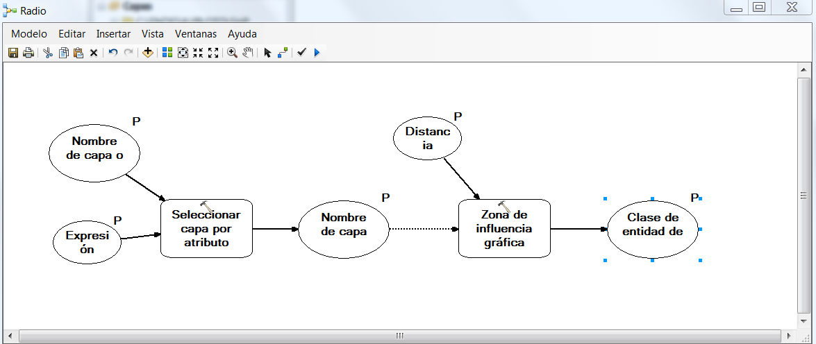

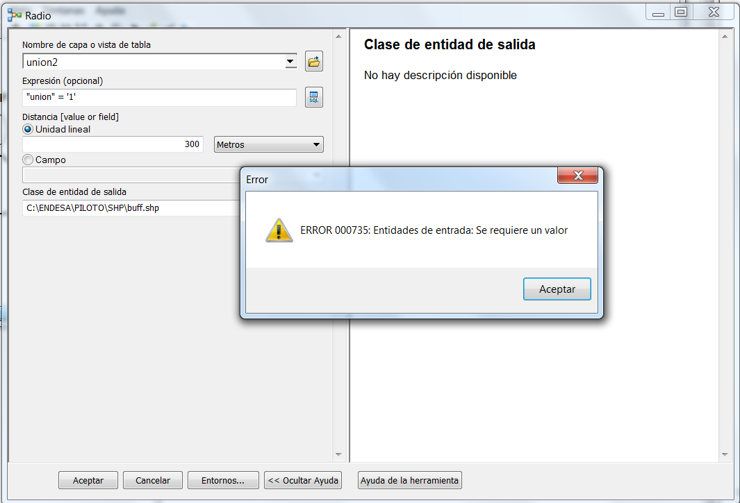

Hola a todos,
estoy intentando crear un modelo sencillo en Model Builder, este trata de una selección por atributo de una capa y que este resultado genere un buffer a esa selección. Añado aquí el modelo para ver si me pueden ayudar, ya que me da un error donde dice que la variable de entrada necesita un valor.
Muchas Gracias
Saludos
Hello everyone,
I am trying to create a simple model in Model Builder, this deals with a selection by attribute of a layer and that this result generates a buffer to that selection. I add the model here to see if they can help me, since it gives me an error where it says that the input variable needs a value.
Thank you
regards

I'm guessing a tool down the chain has a required value  not shown in the model.
I suggest validating the model in model builder editor (that is, populate the inputs and outputs in the editor and run it). This will validate all the tool parameters so you will see what is missing.
