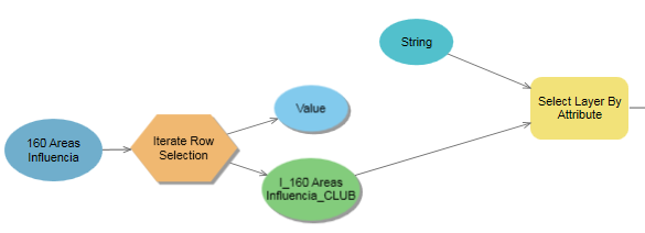

I'm asking this in the specific place for Model Builder as it is the place to be. It originated in the general place.. Macros in ArcGIS Pro?

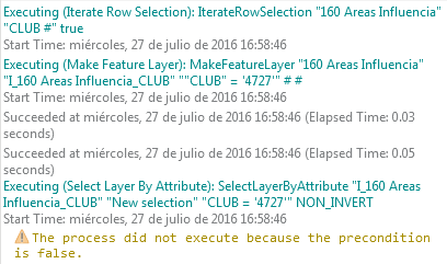

So, the question is: SelectLayerbyAttribute is giving me a Precondition error, any ideas on how to get rid of it?

just to confirm that your parameters are in the correct order... just because it 'looks' like they are, doesn't mean they are...
Changing model parameter order—Help | ArcGIS for Desktop

It's on the right track...
Actually, the iteration takes care of the SELECT LAYER BY ATTRIBUTE, as I'm iterating on the same value... let's see if it works by both arranging the order and removing this tool...
