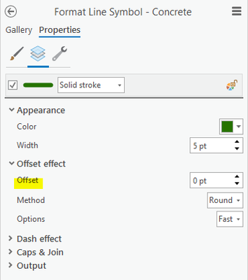

Instead of creating a second layer that contains the same data, you can use the offset line options in the symbology properties of your feature class; assuming you have the variations stored in the attribute table.

I was hoping to tackle this problem on the backend/geoprocessing side of things to maximize the automation of this process.  That said, there seems to be no convenient (out of the box) solution so may need to resort to custom scripting.
Creating the offsets through the symbology is also an option I didn't fully consider, but this is a good fallback plan.
