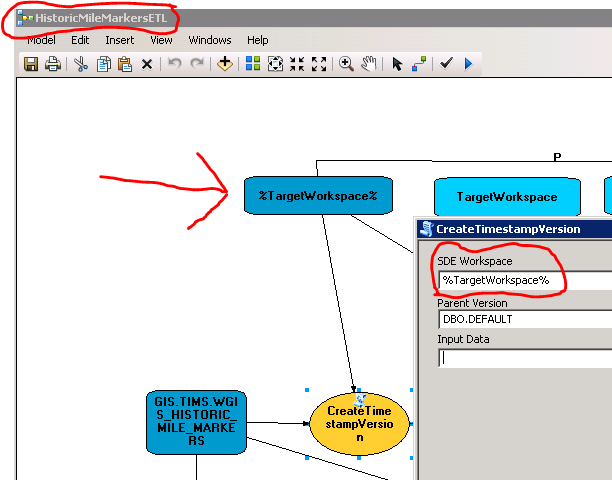

We essentially define our current workspaces without the use of defining a model parameter but it does mean where/when you need a workspace call that you simply connect it to the tool as an input. We assign a workspace (for us a .sde connection) as a data type = workspace and inline variable name of %TargetWorkspace%. This variable we then map into our tools that call for it.
No model level environment variables set:
Connected use of inline variable for %TargetWorkspace% (would be your current workspace) to 3 tools:

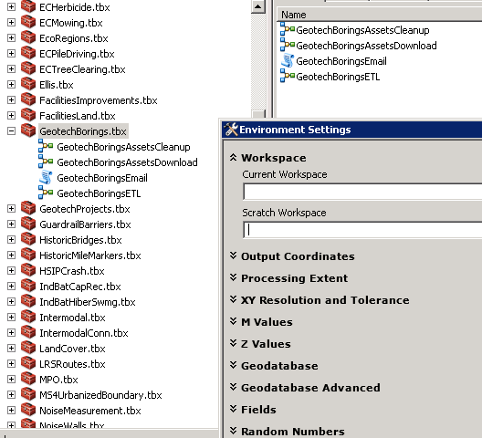

Ohhh ok, sorry I see so I gave you details regarding the individual model level but left out overall environment variables, etc. So below is the screen shot from our desktop environment where we leave those blank and that allows ESRI to use the default paths I had given you before for C:\<user name>
Here is a screen shot of what the published service looks like from the server and as you can see there is no physical scratch.gdb being used the way that there is an output.gdb which is by design because we run a process to zip the output.gdb and provide it through the front end interface for user downloads.
