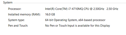

I am using ArcGIS 10.2.1, and windows 8.1 (about to upgrade to 10). See below for my processor info.  I just bought this laptop with the express purpose of running large GIS projects on it.

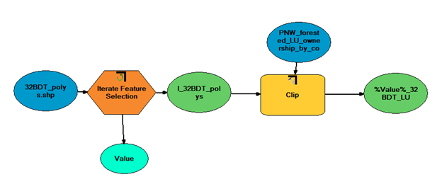

Since I was running it in ModelBuilder there was no Geoprocessing log.  Below is my model.
