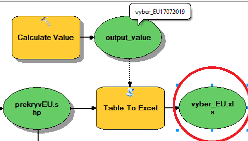

hello guys,
i wanna ask you - i have tool Table to Excel in ModelBuilder but in the end i want to get XLS with output name included Date.
so i used Calculate value and as you can see it is showing correct date...but when i run my model, XLS has output name "vyber_EU".
In Calculate Value i used this expression from mr. Patterson.
time.strftime(u"zzz{0}d{0}m{0}Y".format(chr(37)))
Where is my mistake please?

DuncanHornby
MVP Notable Contributor
That is your problem you are not using the output of the calculate value tool. You have made it a precondition to the table to Excel tool, we know that as it has a dotty line. Your output Excel file should be:
D:\MPRV SR\GSAA\GSAA2019\eustream\vyber_EU%output_value%.xls
If you had renamed the output of your calculate value tool to something like BOB then your output would be:
D:\MPRV SR\GSAA\GSAA2019\eustream\vyber_EU%BOB%.xls
You need to read the help file on modelbuilder in-line substitution, this is particularly important if you are using iterators.
StanislavaV
thank you....:) works now
