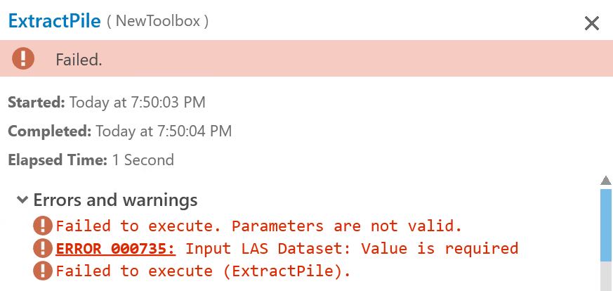

 I've deleted the outputs, saved and validated the model.  But when I try to run my model in the Geoprocessing Pane, I receive this error.  What would cause a tool to fail in the Geoprocessing Pane if it functions in Model Builder?  A bug with Arc Pro?
Error in Geoprocessing Pane

You don't show what your inputs are so no one can answer this question! You just mention an error.
That said reading the Help file, Input is a LAS Dataset Layer this is what is explained in the syntax section.
If you read the usage section it talks about the  Make LAS Dataset Layer  tool, so you need to create a LAS Dataset layer to feed into your tool, not a path to a las file. This is what I can only guess is happening?
