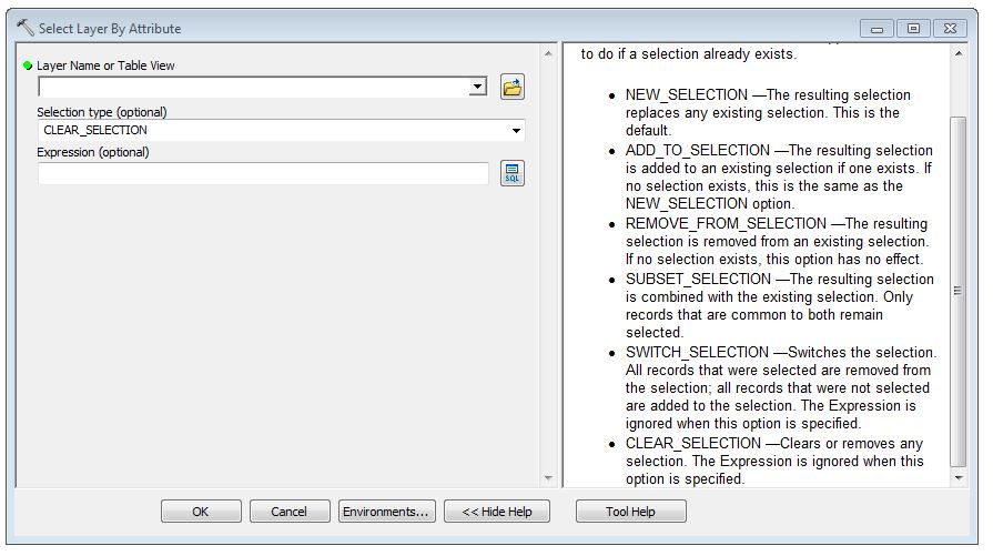

I'm selecting a set of rows using using "Iteration Row Selection"and "select based on location tool" using FC1 & FC2 in a model and copying to another layer .
Next step i've to clear the selection of FC2 and make new selection based on the iteration of FC1. How do i clear the selection in model Builder?
Tags (1)
ChrisDonohue__GISP
MVP Alum
Not sure, but Select Layer By Attribute (Data Management) with the Selection type (optional) of Clear Selection may be what you are looking for.  However, this will not reset your Iterator, if that is instead what you are looking for.
