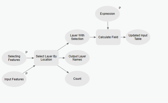

Have a model of nothing more than a select by location feeding into a field calculate. As @curtvprice  says all tools honour selections. Of cause you can shoot yourself in the foot, if no selection is created then the field calculate will apply to all rows in your data and potentially overwrite important data. Something to be aware of, I only have a few toes left  😉
 Typically the select by location takes a layer to do the selection (which it self may have a selection on it). If you want to interactively draw a polygon on the screen that then becomes the geometry that does the selecting you need to expose the parameter as a FeatureSet. You need to expose it as a parameter so it allows you to interact with it and use it to draw a temporary polygon on your map.
So using ArcPro as by way of example (you can do this in ArcMap) here is the model, note some of the parameters have a "P" indicating they are model tool parameters.

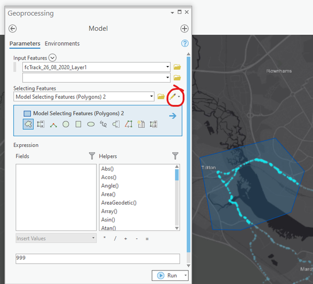

The model running as a tool looks like this:
Clicking on the pencil icon allows you to draw any geometry and it is that that feeds into the select tool

In the model right click on the tool itself (square box) and choose Create Variable>From Parameter to show it on the model. Then to turn it into a parameter to allow you to change the value to anything, right click on the input and select parameter. You then run the model directly from the toolbox (so open it not edit it).
