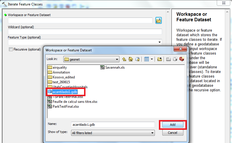

I think you only have Feature Classes inside the Geodatabase (No Feature Dataset). In this case, you just need to select the Geodatabase as your workspace (Do not double-click the database. Just single-click > Add).
Iterate Feature Classes—Help | ArcGIS for Desktop
