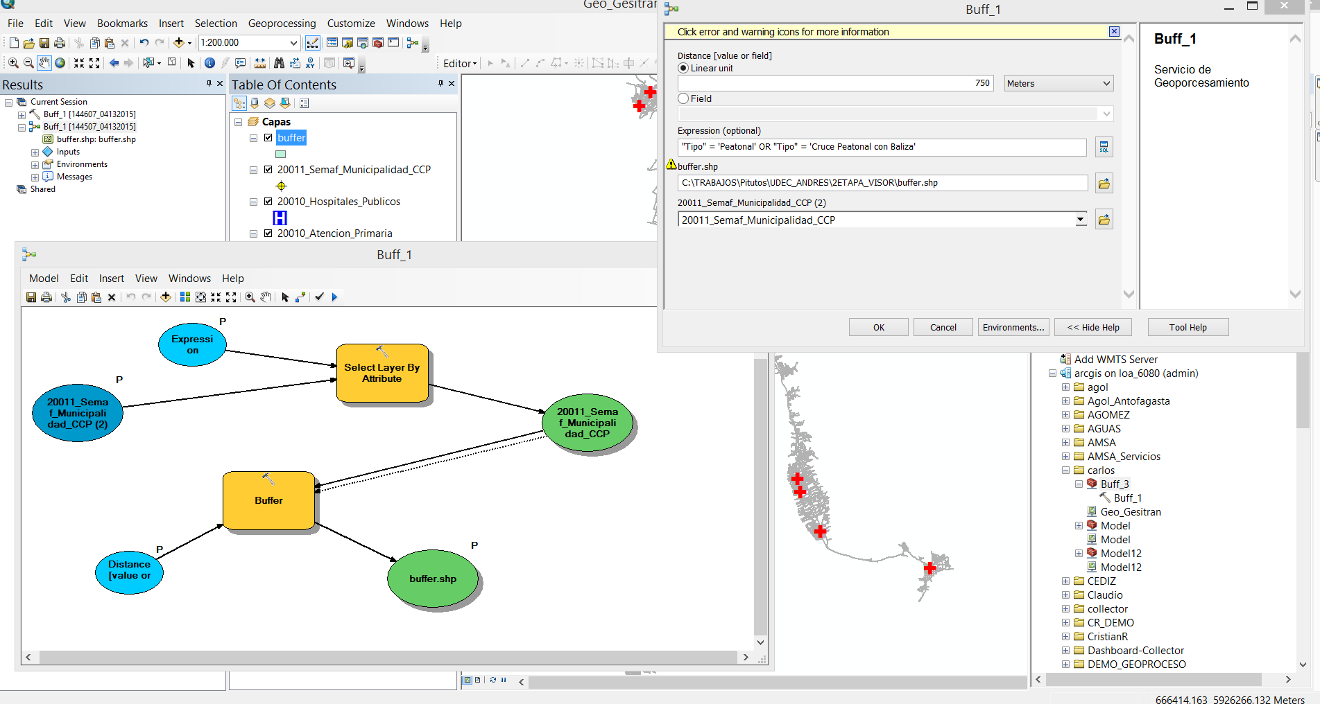

Hello.
I am writing because I am creating a model in ArcGIS Model Builder 10.2.2. The main purpose of this is to publish in arcgisserver as GPService then take that service and create a viewer in javascript with the objective of perform a specific geoprocessing.
We templates viewers and we know what will be the viewer will use, but to develop the button with the geoprocess (Geoprocess buffer) requests a parameter. The model which was published has parameters but in reality the code says that the model does not have parameters ... anyone know if the model builder must have some prerequisite before publishing it as a service ??
I'm attaching the model and a video that reproduces the model.
2015-04-13_1446 - BGALVEZS's library
I thank you in advance for your orientation.
