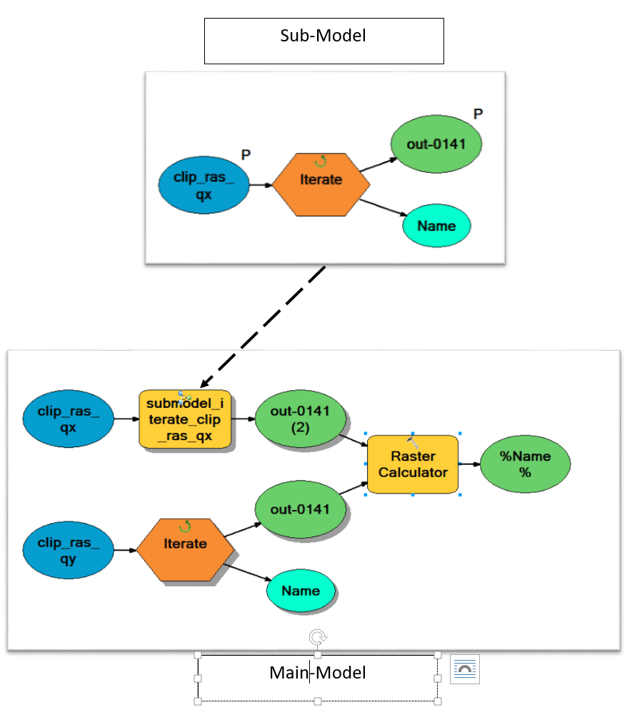

My initial setup is as follows (since you can only use 1 iterator in a model):
For this trial, I only used 5 rasters both for qx and qy. The model actually ran the calculation but the terms used were not correct. Please see below:
qy1 and qx5
qy2 and qx5
qy3 and qx5
qy4 and qx5
qy5 and qx5
Qy (iteration in the main model) was correctly iterated but not in the case of Qx. I hope you can help me with this problem. Thank you!

This is how loops work. If you want to operate on pairs you need to only do one iterator on qx and somehow create the path to qy from qx. No nesting needed.
In python scripts you can easily loop over a list of 2 item lists, but this isn't easily accomplished in ModelBuilder.

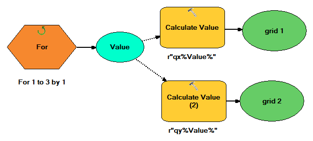

Here is a model that uses the For tool in this way. You can get this to work by modifying the Calculate Value tools to construct a full file path, and set the outputs to type Raster Dataset. Then use the model elements grid1 and grid2 in the Map Algebra tool. I have connected the Value element to the tools as a precondition to ensure both Calculate Value tools run on every iteration.
