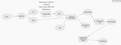

Iterate Workspaces tool currently does not support BIM File Workspace format. You could try to use Iterate Files tool to iterate through the folder with rvt files. Each file can be converted to the BIM File Workspace format using Calculate Value tool. Then the output of Calculate Value tool can be used as the input of BIM File To Geodatabase.
As an example:
