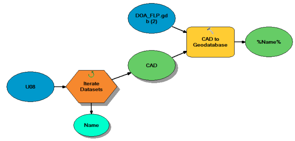

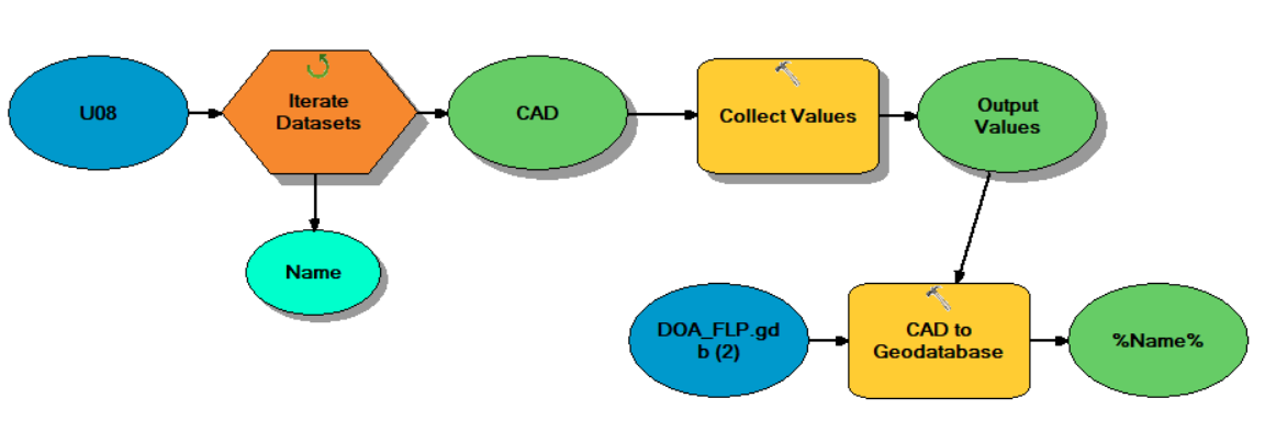

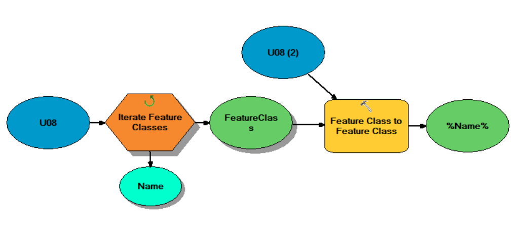

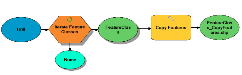

I've tried every way I could find to iterate through a file directory, extract CAD files, and then copy the CAD lines to a geodatabase. I want to avoid having to append each dataset individually to a matching db layer. I tried using a number of tools and combinations of tools and settings, creating new feature classes vs using existing ones. I am using Arc 10.6, and Autodesk 2018.
Nothing works. All I get are errors and empty outputs. I'd like to do this in model builder but wondering if it is even possible? None of these tools seem to do what they say they do. Just a few of the many things I've tried are shown below. Can anyone point me to a workflow that actually works?

Thank you for the reply and for posting those links. I had seen those threads previously, and I have tried the iterate dataset & feature class to feature class, as well as iterate feature class & copy methods he describes. Neither version returned anything for me except empty outputs and generic error messages.
I'm not able to copy the CAD data using any of these tools connected to an iterator. The only way that has worked so far is using "append" outside of iterating, by matching up every CAD file separately in my model to its created database layer (which I do not want to do for entire directories of CAD files).
I'm wondering if there is some compatibility issue with model builder reading newer CAD files?

I was able to get Iterate Feature Classes to work with Feature Class to Geodatabase to output CAD layers to a empty geodb. This still doesn't work well however, since I can't tell it which CAD files I want to use for iteration. I end up processing many files I don't need or want.
The wildcard in the iterator doesn't work when the name you want to search for in in the middle of a file name. Example: I have a folder with lots of CAD files all with different naming conventions. I want to use wildcard to keep only CAD layers with a string "value" in the file name:
"data-1 my value.dwg", "data-1_yourvalues.dwg", "some_other_value1.dwg".
-   Cant use *value* or value*. Is there any way to do this?
