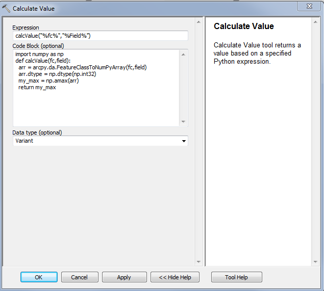

I want to have a function in my model that converts an arbitrary value to a percentage within that column's range. It would need to be dynamic. Right now I have:
def prob( Failure_Score 😞
   my_list = arcpy.da.TableToNumPyArray ("Failure_Score")
   my_max = max(my_list)
   percentage = (Failure_Score / my_max)*100
   return percentage
but it returns nothing. Really any advice would be greatly appreciated.
Thanks!
5 Replies
AbdullahAnter
Honored Contributor
You can put  Summary Statistics tool and operate this for your field to get maximum value , then you can get this value by using Get Field Value tool , and use this Value in your expression.
FrankWakeley
Deactivated User
Would I be able to input that value dynamically or would it be manually input each iteration?
AbdullahAnter
Honored Contributor
if you put the tools in correctly way, the value will be generate dynamically each iteration.
DuncanHornby
MVP Notable Contributor
The reason why your code above is failing is because you have not entered all the required parameters to the function TableToNumPyArray(). If you read the help file for this function you will see that it takes two parameters Table name and a list of fields, the remaining 3 parameters are optional. The Syntax section of the help file for any function explains the parameter order. You should spend some time getting yourself familiar in reading these documents.
