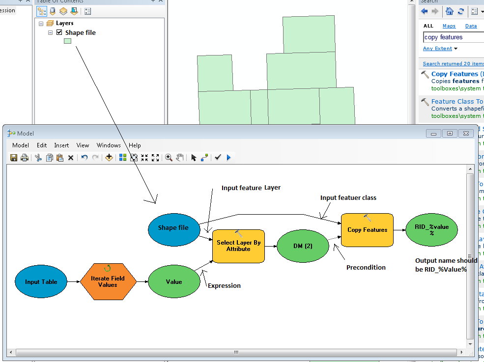

BrianWade
Good Morning Kishor
Thanks for replying to my selecting using table input question. I created a quick model using what I think your attempting to show me and it failed.
I assume, not being a regular model builder user, that my issue is in the select layer by Attribute portion of the model. How do I get the value out from the Iterate field values tool to
Be used as a valid expression into the select layer by attribute?
I linked the value as an expression  to the select Layer by Attribute tool but it appears that that’s where the model is breaking.
See attached clip below,
Any Help is appreciated
