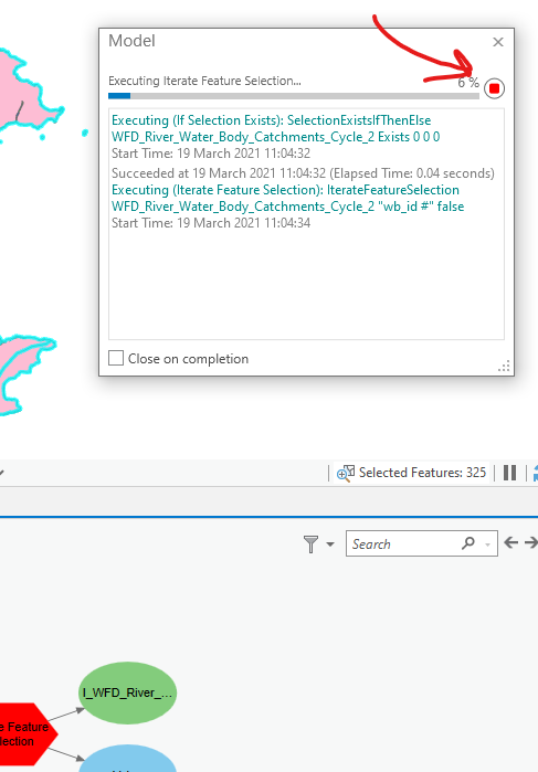

I create a model and press run. If I want to stop the model I click on the red square on the dialog window as indicated by my arrow
Now dare I say it but I am but a mere mortal with many flaws and sometime I inadvertently click on the tiny cross which closes the dialog window. Why you ask? Well it is Friday...
How do I get back to that window so I can stop the model! You know the model is still running as ArcPro is sluggish and task manager says its doing something. I've not found a way of getting back to a running model to cancel it.

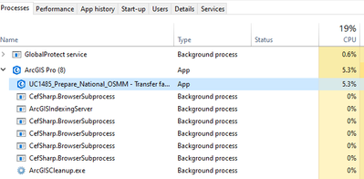

ctrl alt del task manager  Is it showing a separate process for the model?
... sort of retired...
DuncanHornby
MVP Notable Contributor
No it's the main application process, if I stopped that I would be killing the ArcPro too which I do not want to do.
