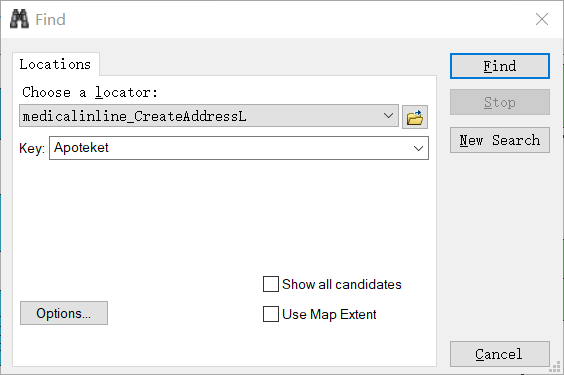

Hi,
I want to use the function of "find address" in model builder and I have created an address locator, how do I get the picture displayed below in model builder?
Thank you so much.
MarisaClaggett
Hi Feng,
You will have to use the Geocode addresses geoprocessnig tool within your model.  This will require that you create a table that contains the address of your choice.  Depending on your type of address locator, that will determine the schema used in the table to organize the address components.
Geocode Addresses—Help | ArcGIS Desktop
Hope this helps!
Marisa
