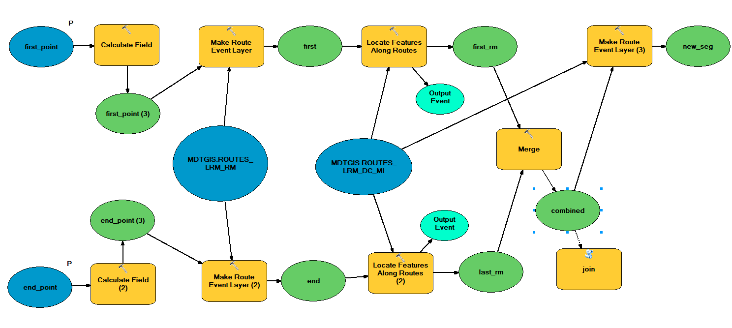

I have built a model and within the model I perform a merge. that creates a table.  I have a script that creates one record from that table.  I want to make a route event layer from this table.  The problem I have is the script is the last thing to run so the make route event layer fails.  I thought setting the precondition on the created table would make the script run before the table is used by the Make Route Event tool.  Is there a way to force the script to run on the table before the Make Route Event Layer?  Here is the code in my script.

This is what my model looks like.

Instead of precondition, I suggest setting up script tool input and output parameters like this
table = arcpy.GetParameterAsText(0) # parameter 0: input table (Table View)
arcpy.SetParameterAsText(1, True) # parameter 1: result (Boolean)‍‍‍‍‍‍‍‍‍‍
Setting script tool parameters—Help | ArcGIS Desktop
Then connect the combine table (data element in your model) to the script tool, and connect the script tool output to the Make Route Event Layer tool as a precondition. That should do it.

Another approach:
For a short bit if python snippet like this you can also use the Calculate Value tool and write a python function for your code, this can save you from the hassle of a separate script tool, passing parameters as text, and all that jazz.
# Calculate Value expression
proc(r"%combine%") # set combine as precondition to this CV tool
