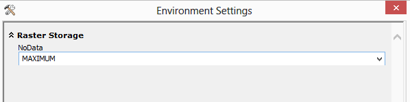

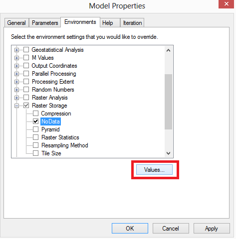

In Model Builder > Model > Model Properties > Environments
Change the NoData Value as Maximum. Is it helping?

Thanks for the suggestion i think this might be in a newer version of arcmap than i'm using i can only see the following options. (ArcView v10 SP5)

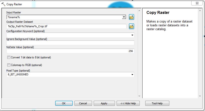

I also tried adding an additional tool on the end of my model (Copy Raster) with it set to 8 bit unsigned but these files just exported as tiny corrupt files.

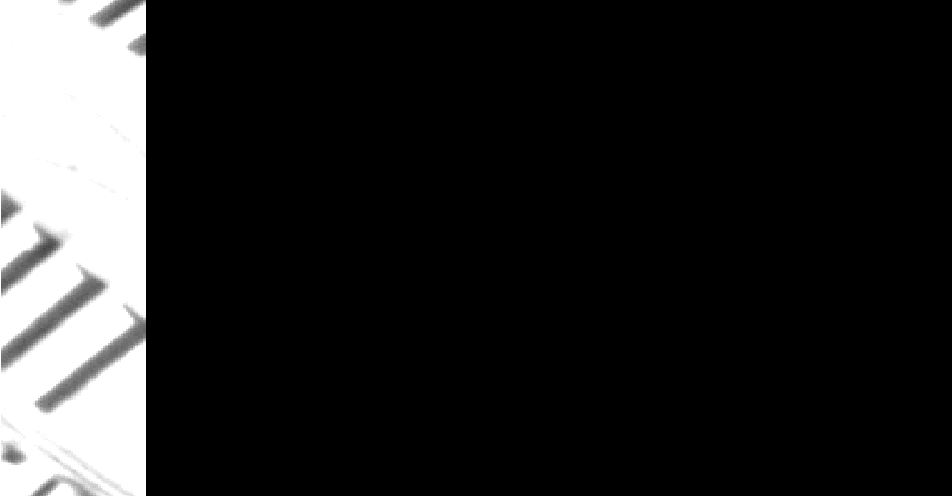

Good suggestion Curtis unfortunately it didn't work. The files still didn't open in picture viewer and the image was left mostly blank.
