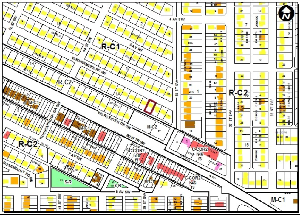

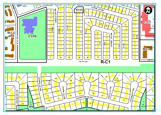

Something interesting is that while the image exported is what I'm expecting:
Nothing ever changed in the map window from when the mxd opened. I always expected that the extent would change in the map window and then the image would be created based on that:
