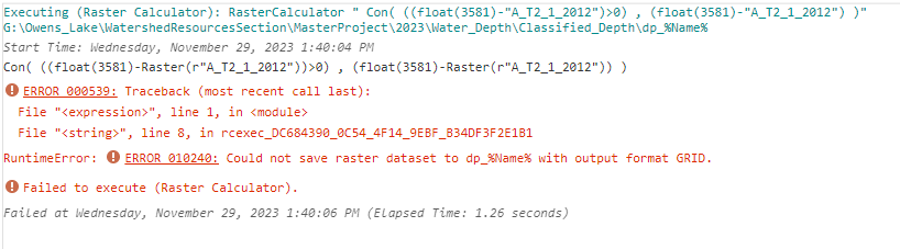

EERROR 010240: Could not save raster dataset to dp_%Name% with output format GRID.

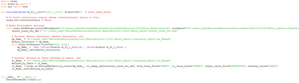

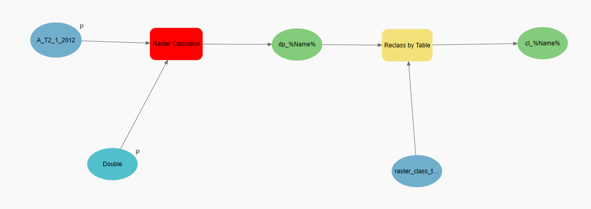

I have tried changing my file type, saving to different drives, and changing the scratch and current workspace to separate folders. I have included a picture of my model, the error message I am getting, and the python code generated from ModelBuilder. Any help would be appreciated.

Your model is using inline variable substitution as you have %Name% at the end of the raster dataset name. But nowhere in your model do you have a variable called Name with a value to substitute into. Add a text variable called Name to your model, fill it with simple text, e.g. water and the output raster will ultimate be called dp_water.
