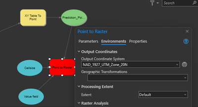

I think there might be some issue with the data, but I don't really understand what's going on.
ERROR 000918: Cannot retrieve feature class extent.
I also have these warnings:
WARNING 100160: Some of the features have invalid geometry and have been removed from the result
WARNING 000192: Invalid value for rows: 1, 2, 3, 4, 5, 6, 7, 8, 9, 10, 11, 12, 13, 14, 15, 16, 17, 18, 19, 20, 21, 22, 23, 24, 25, 26, 27, 28, 29, 30, 31, 32, 33, 34, 35, 36, 37,

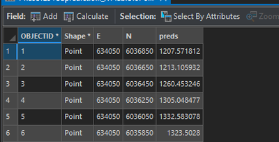

I'm successful in getting the data from the csv into a point feature. And it plots as I expected and the attribute seems right:
I'm not even sure how to troubleshoot this.  Any advice or help?

Are you using
Point to Raster (Conversion)—ArcGIS Pro | Documentation
and if so, what coordinate system did you define it as?

DrewHeasman1
That's the one I'm using yes.  I define the coordinate system as NAD 1927 UTM Zone 20N,
It seems to be in the model setting somehow.  If I step through the process manually, it works.
DanPatterson
MVP Esteemed Contributor
So if everything is in the same coordinate system, you might want to look at the "extent" which is set to Default. which is unknown and it may be that the points don't overlap your other data's extent

curtvprice
MVP Alum
Have you assigned the E field to X and the N field to Y? If they were reversed this would create some really weird UTM locations (way off zone) which would explain the invalid geometry warning.
