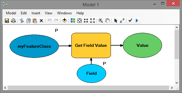

EDIT: I've found a way to do it using the 'Get Field Value' Utility... but this only accepts tables as inputs, not feature classes. How can I extract field values from feature classes?
XanderBakker
Esri Esteemed Contributor
In fact the Get Field Value—Help | ArcGIS for Desktop  tool (although it mentions "tables" in the help) also allows the use of featureclasses.
curtvprice
MVP Alum
This should work with any tool that takes a layer/feature class/table/table view and a field as input if you mark the dataset input and the field input as input parameters, not just Get Field Value.

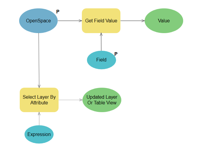

I have the following model set up:

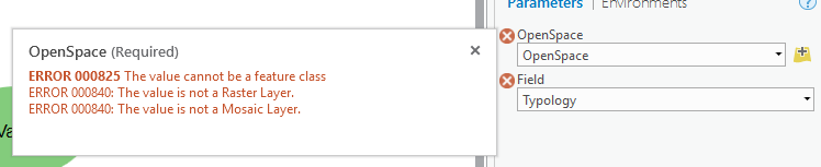

but whenever I try to change the input feature class my model won't run because of the following errors:
How do I set up this tool so that it accepts feature classes? Am I doing something obviously wrong here??

what is the OpenSpace parameter defined as? The only reference I could fine had something to do with cityengine.  The error is saying that that parameter has to be of a particular type and featureclass etc isn't one of them
LukeHaskett
I seem to have fixed it by using the 'Make Feature Layer' tool as an intermediary - the field value tool is happy with a feature layer, just not a feature class.
curtvprice
MVP Alum
Select Layer by Attribute requires an input feature layer, if you want to use that tool you need to make a layer from your input in case it is a feature class.
