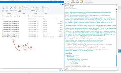

The process "calculate values" seems to have created the zip file just fine, but the model builder is stuck on the step.  The zip file was created and has not changed file size for about 20 minutes.  See screen shot:
I can't understand what would hang it up.

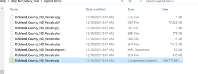

Update to this:  I force killed the process through task manager, and the file size had grown huge, and it was an invalid file when I tried to open.  See screen shot:
curtvprice
MVP Alum
That's really weird as it worked for me - but my test model didn't create the shapefile, I gave it a path to an existing one. Too bad the zip isn't valid as I can't imagine what it was trying to stuff in there. Thanks for the really detailed screenshot, I will look at the puzzle.

Could this be stuffing the zipfile that it is creating into the zipfile that it is creating, creating a loop of sorts?

Improved, skipping the zip to avoid trying to write it into itself:
import os
import glob
import zipfile
def zipshape(folder, name):
    os.chdir(folder)
    zipname = name + ".zip"
    flist = glob.glob(name + ".*")
    with zipfile.ZipFile(zipname, "w") as newzip:
        for ff in flist:
            if ff[-4:] != "lock" and ff != zipname:
                newzip.write(ff)
    return os.path.join(folder, zipname)
Syvertson
This worked perfectly.  Thanks so much for helping me with this!
