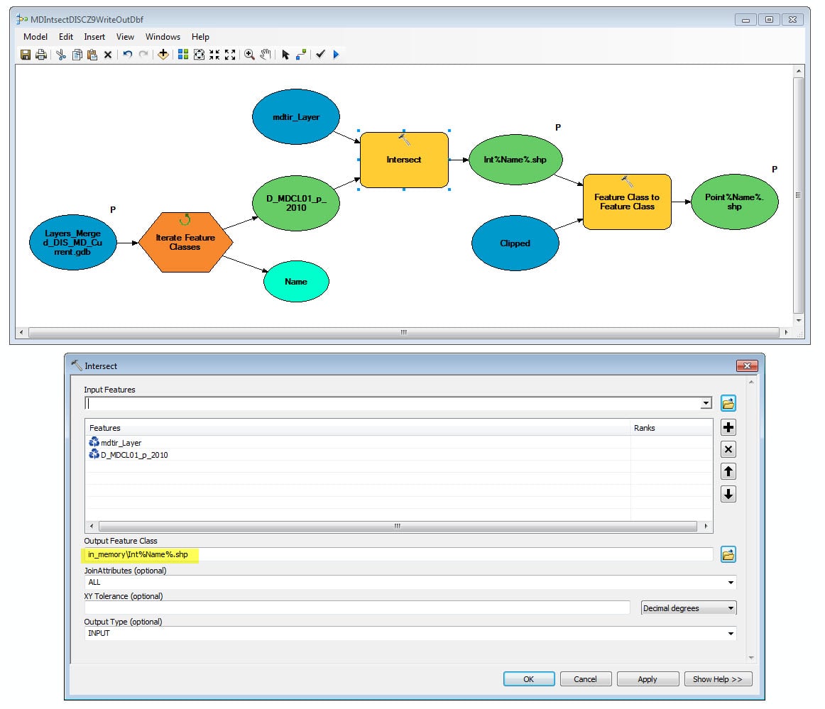

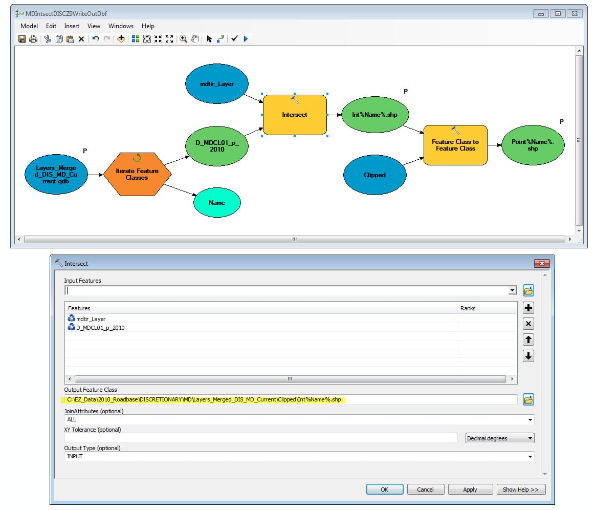

In ModelBuilder I’m iterating multiple shapefiles to intersect against a single point layer, then write out using feature Class to Feature Class tool (I only want 2 columns in the output file).
I would like to have the Intersection output "in_memory" for quicker processing.
I also need to have the input polygon filename in the final output.
This works without the "in_memory"

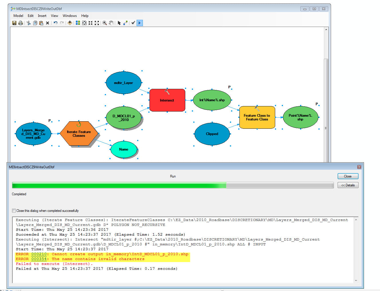

Seeing the error message below is leading me to believe my issue is that I can't combine "in_memory" with a %name% inline variable as output of my intersect tool?
Also if I can accomplish this, won't I need to change my Feature Class to Feature Class tools input to in_memory also?
Any Help is appreciated

In memory data is stored in a in_memory geodatabase - I see you are trying to send your in_memory output to a folder - that's why your execution is failing. Just take the .shp off from your output name and try again.

yep, tried it
"ERROR 000354: The name contains invalid characters
Failed to execute (Intersect)."
what do you thinks invalid? the "%" or maybe the "_" in my polygon shapefile polynames?

Your output should look like this:
in_memory\Int%Name%
And take off the .shp from name as output goes to a geodatabase, an extension of *.shp is invalid.

The Intersect output name should not be constructed using the pathname output from the iterator because that includes the ".shp".
 I usually name intermediate data something simple and obviously temporary like "in_memory\xxint001" because it's clearly throw away. I notice You have your Intersect output set to be a parameter, I don't see a reason to do this as it will prevent it from being automatically deleted by "Remove Intermediate data".
The output of feature class to feature class can be defined however you want, I'd use %Name%  as part of the name and not make it parameter if you want the iterator to name it. However, I would expose the output workspace parameter of  FCtoFC as an parameter. (Right click the tool, make parameter from...)
