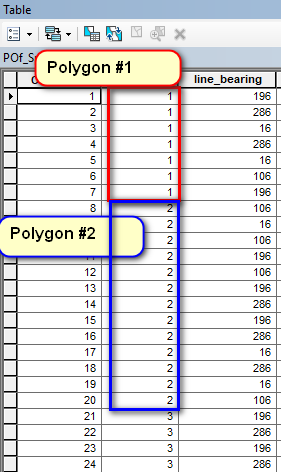

I have some polygons and I want to calculate the inner angle of each polygon. Now, I have the geometry of every line of polygons in the same attribute table as shown in the following image.
I want to calculate the inner angle using the following equation:
inner_angle= the bearing angle of the previous line - the bearing angle of the following line +180 (in degrees).

screen grab of your first 2 polygons? just to confirm something
and you are working with full circle angles and not angles from north I presume
Ahmad_Muhamad_Senousi_Ahmad
Yes. The attached image just illustrates geometry table of points.
