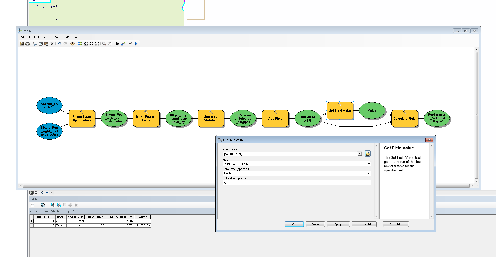

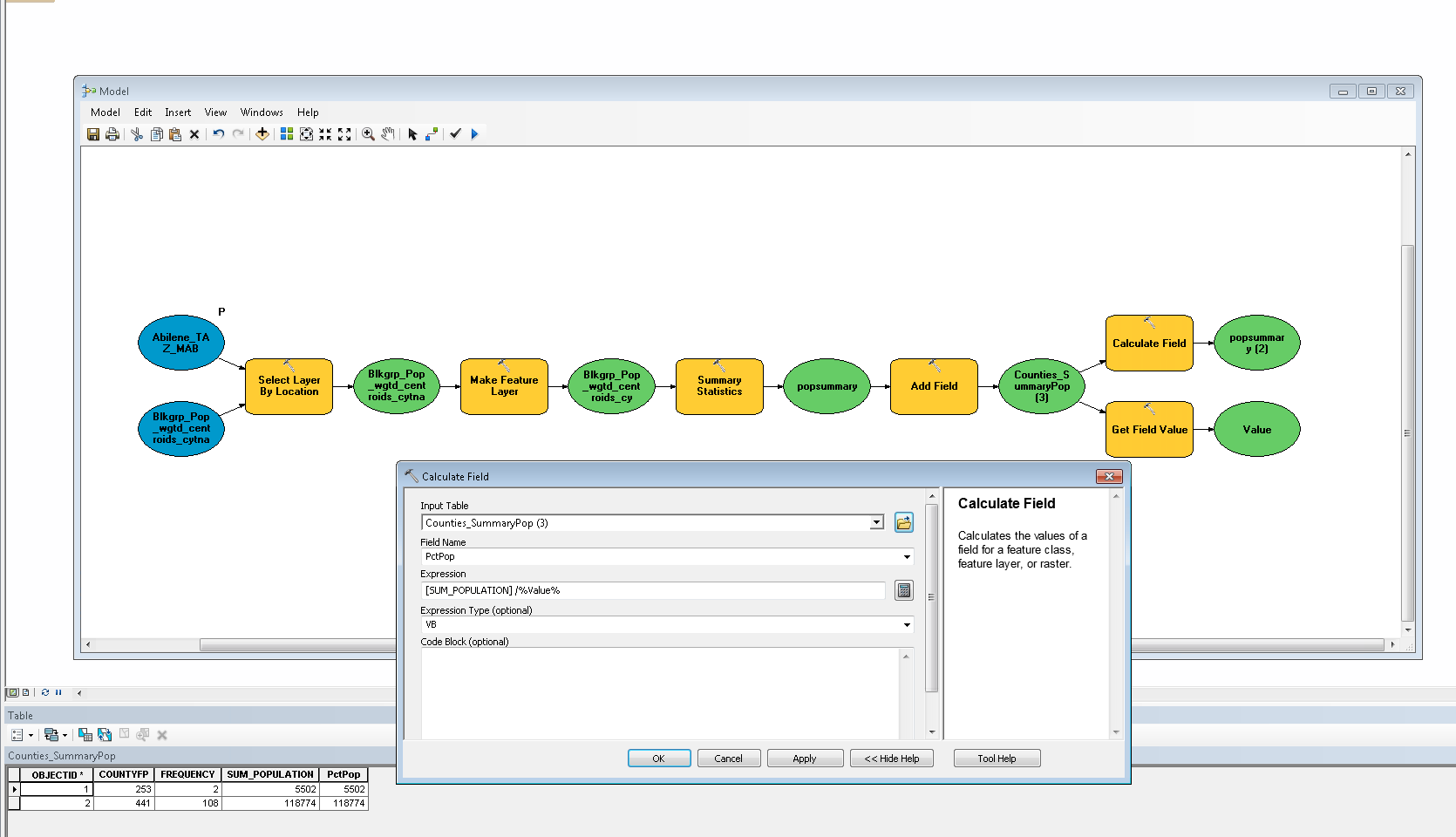

I am trying to calculate percent population using this model, it runs gives no error but the PctPop field is not giving the correct value, it just putting the SUM_POPULATION in place of calculating the percentage, as seen the table included in the image.
Also under current session, it has no results under geoprocessing, after the model runs, why is that?

Is the field "SUM_POPULATION" the sum of the counties population or the total population of the metro area?  I ask as I see "SUM_POPULATION" in both the Calculate Field and Get Field processes, but don't see another field that would represent the other value.  I may be missing something obvious, but it seems like we are missing one of the fields as an input needed to calculate the percentage.

My first thought it that a Precondition may need to be established.  Otherwise the Calculate Field might run before the Get Field Value.  However, I am not certain that is what is causing the issue.  Might be worth a try, though.

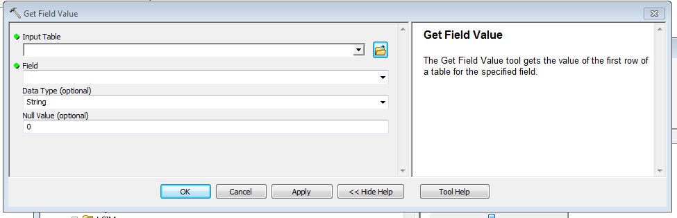

To help in troubleshooting, can you post what the Get Field Value tool inputs look like?  I.e. what is filled in here:

I tried after setting the precondition that you suggested, it is now calculating some value in PctPop, but not the correct percentage value, that I get using the field calculator

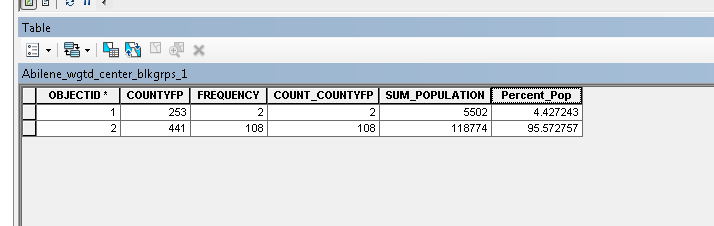

JssrRR
Chis,
I figured it out, I had to add another summary statistics and take the value from the first one and use the Calculate field with second table as an input and it gives me the percentages for each county in my Percent Population in the second table.
