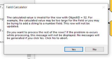

c. with VB I get an alert:
If I click yes it finishes.
the same happens for a filed that needs to be converted in float.
I need to get rid of this alert.

Regarding
Since I need to convert this values into numbers I remove the word nan by using the python exp.: !ACmodeString!.replace("nan","<Null>").
The Python expression above hasn't changed "nan" to Null, it has changed "nan" to "<Null>".  What you have done is changed the string value to another string value with the characters that spell out Null, is isn't actually Null.  If you open the Select Layer By Attribute tool and query the table like, "field IS NULL" (use actual field name), you will see no records are selected.
Do you want the "nan" records to get converted and stay NULL, or do you want to eventually change them to some number like 0, -9999, etc....?
