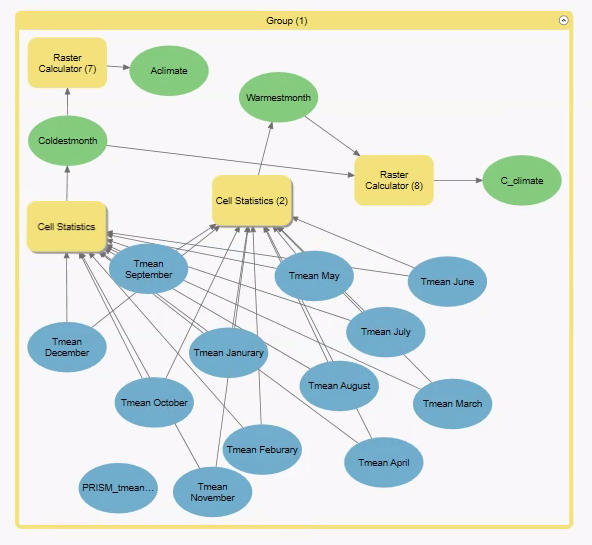

The picture is my modelbuilder. For some reason, after I click "Add to display", it never shows up on my map nor on my geodatabase. Also, the raster calculator (8) does not have the shade and it says "all the current input are not current". It still runs but just never gets the shade around it. What is going on?
curtvprice
MVP Alum
Be sure and validate before you run.  If it isn't shading it means it did not run to completion, which means the output cannot be added to the map.
If it really is not running as expected, clear things out by validating and saving the model and project, close Pro, open Pro, and see if it starts behaving. In my experience this OFTEN helps when things are just acting weird, the restart releases all file locks, clears memory of cruft, etc. and everything magically works again after the restart.
