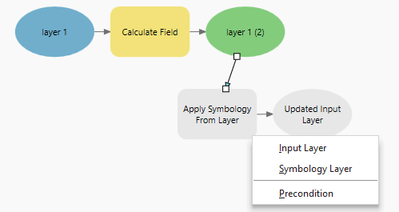

Probably you could try the following two approaches:
  1. Provide the Calculate Field tool with valid layer layer input, field name and expression. After the Calculate Field tool becomes valid, it allows connecting to Apply Symbology From Layer tool as Input Layer or Symbology Layer. You can remove the Calculate Field input layer value after connection.

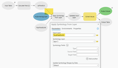

  2. If you prefer not filling in the Calculate Field tool, you can try use inline variable substitution.
    In the Apply Symbology From Layer tool, specify %use_calculate_ field_output_variable_ name_in_between_percent_symbols% as the Input Layer parameter. Also draw a precondition link between Calculate Field tool and Apply Symbology From Layer tool. This should work as well.
